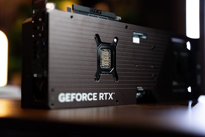

- Backplate. Modern graphics cards often include a backplate on the rear of the PCB, primarily to provide rigidity and structural integrity. However, some backplates assist with cooling, as well, through ventilation and/or thermal pads that help keep temperatures low.

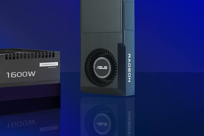

If you’re building a PC in a small chassis where there’s limited room for airflow, you might consider a blower-style cooler instead. Blower-style coolers have a single fan that draws in cool air at one end of the card and pushes it through the heatsink. The GPU shroud channels warmed air out through a dedicated vent in the bracket that you use to mount your graphics card to your case.
The key advantage of a blower-style cooler is that it prevents hot air from recirculating inside your case. This can be an important concern if you’re building in a case that doesn’t have enough room for a wide airflow path. However, blower-style coolers have limitations. Since they only use one fan, and this fan is almost always smaller than the ones on an open-air cooler, this fan must do all the heavy lifting by itself — and it’s usually noisier as a result. Blower-style coolers have limited cooling capacity compared to open-air coolers, so they’re not well-suited for high-end graphics cards, which produce more heat.

While we don’t recommend blower-style GPU coolers for everyone, there are scenarios where they’re a reasonable choice. They’re worth considering if you’re building a PC in a smaller chassis without as much room for airflow, but arguably they’re most relevant in 2025 for multi-GPU workstations. The ASUS Turbo Radeon™ AI Pro R9700, for instance, is perfect for users going big on VRAM to accelerate AI workflows or content creation tasks.
