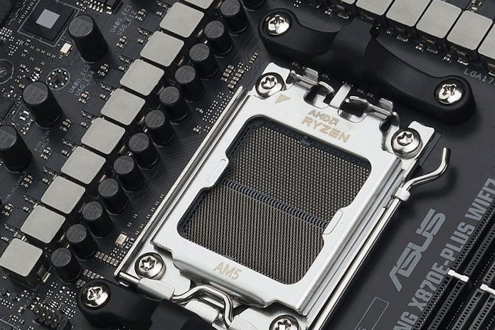

Power solutions have many components, starting with connectors on your motherboard that provide a direct line to your power supply. From there, a voltage regulator module (VRM) controls the voltage sent along to the CPU. VRMs are subdivided into individual power stages, each with a choke and capacitor. You might expect that all the power stages in your VRM would be running all the time, but that’s not actually true. To reduce the workload for any individual power stage, they actually take turns delivering electricity to the CPU. Under load, power stages create heat, which has to be managed and dissipated for peak performance and long-term reliability. That’s why VRMs also typically have dedicated cooling hardware.

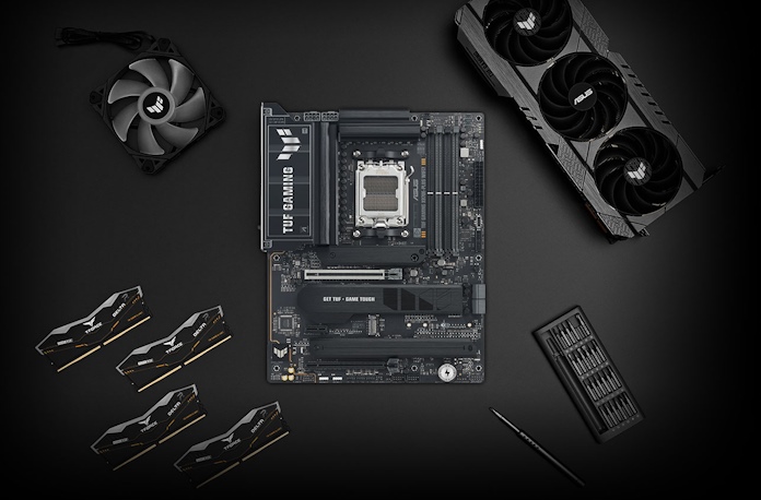

The TUF Gaming X870E-Plus WiFi motherboard on a table with other PC building components
If you’re building a gaming PC for the Ryzen 7 7800X3D, you don’t necessarily need the beefiest power solution on the market. In many ways, the TUF Gaming X870E-Plus WiFi7 is the perfect fit. This motherboard wields 16+2+1 power stages that integrate high-side and low-side MOSFETs and drivers into packages rated for up to 80A each. This configuration ensures optimal power delivery, efficiency, stability, and performance. Comparable boards from our competitors sometimes cap out at 12 or 14 power stages dedicated to VCORE, all while costing about the same as the TUF model. You probably won’t notice the difference between the power solutions of these different motherboards on your first day of use, but the TUF Gaming board is more likely to give you a long life of service thanks to its bolstered power stage count.
